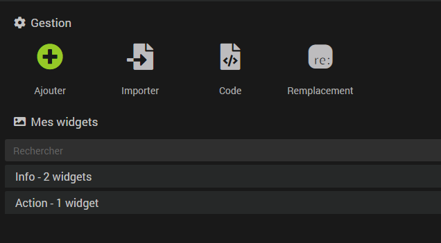

Gestion
Widget
You have four options :
My widgets

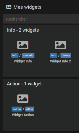

In this part you will find all the widgets that you have created classified by type.
Mes Widget
TRICK
You can open a widget by doing :
  • Click on one of them.
  • Ctrl + Click or Click + Center to open it in a new browser tab.
The search engine allows you to filter the display of widgets according to different criteria (name, type, subtype, etc…). The Esc key cancels the search.
