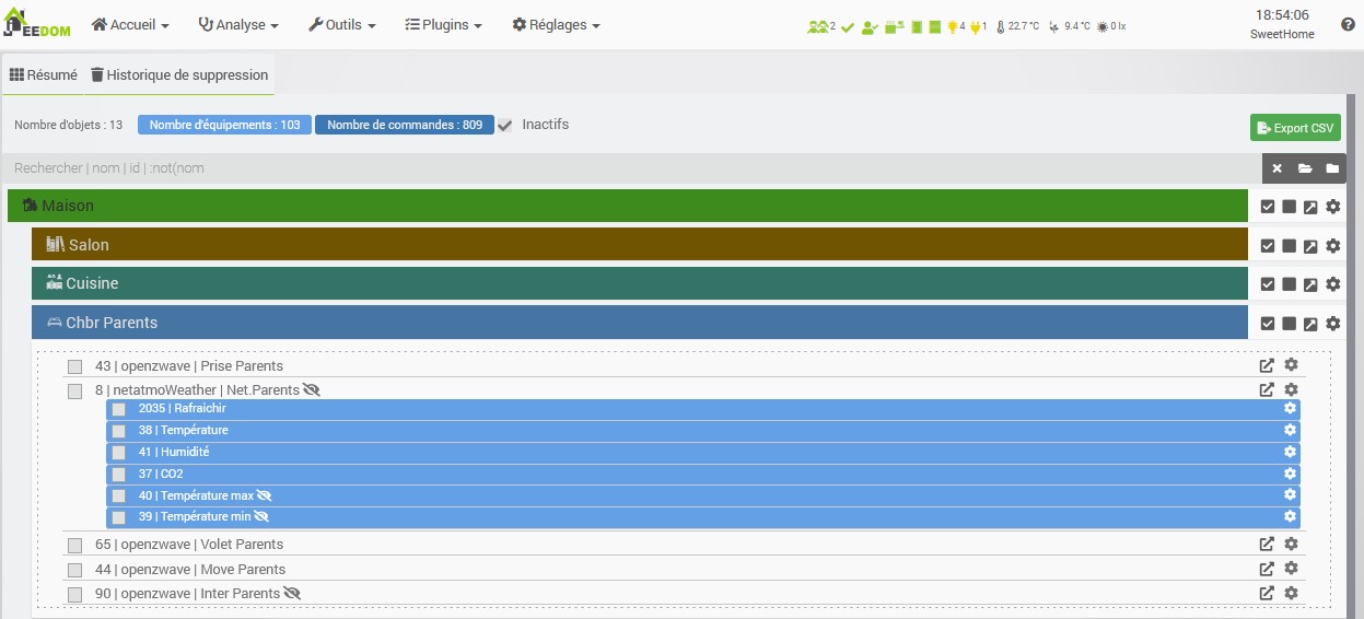

This page allows you to gather on a single page the different elements configured on your Jeedom. It also gives access to functions for organizing equipment and controls, to their advanced configuration and to display configuration possibilities.
On the top of the page, we find :
- Number of objects : Total number of objects configured in our Jeedom, including inactive elements.
- Number of equipments : Same for the equipment.
- Number of commands : Same for commands.
- Inactive : Check this box if you want inactive items to be displayed on this page.
- To research : Search for a particular item. It can be the name of a device, a command or the name of the plugin by which the device was created.
- CSV export : Allows you to export all objects, equipment and their commands to a CSV file.
You also have a tab Historical, displaying the history of commands, equipment, objects, views, design, 3d design, scenarios and deleted users.
Object frames
Below there is one frame per object. In each frame, we find the list of equipment that have this object as parent.
The first frame Any represents devices that have no assigned parent.
For each object, next to its label, two buttons are available.
- The first is used to open the object configuration page in a new tab.
- The second provides some information on the object,
Tip
The background color of the object frames depends on the color chosen in the configuration of the object.
Tip
With a click and drop on the objects or equipment, you can change their order or even assign them to another object. It is from the order established on this page that the display of the Dashboard is calculated.
The equipments
On each equipment we find :
- A check box to select the equipment (you can select several). If at least one device is selected, you have action buttons that appear in the upper left to remove, to return visible/invisible, active/Inactive selected equipment.
- L’id equipment.
- The type equipment : Identifier of the plugin to which it belongs.
- The name equipment.
- Inactive (small cross) : Means that the equipment is inactive (if it is not there, the equipment is active).
- Invisible (crossed eye) : Means that the equipment is invisible (if it is not there, the equipment is visible).
If the equipment plugin is disabled, the two icons on the right do not appear:
- External link (square with arrow) : Allows to open in a new tab the equipment configuration page.
- Advanced configuration (toothed wheel) : opens the advanced equipment configuration window.
By clicking on the line containing the name of the equipment, you will display all the commands for this equipment. By clicking on an command, you will access the command configuration window.
