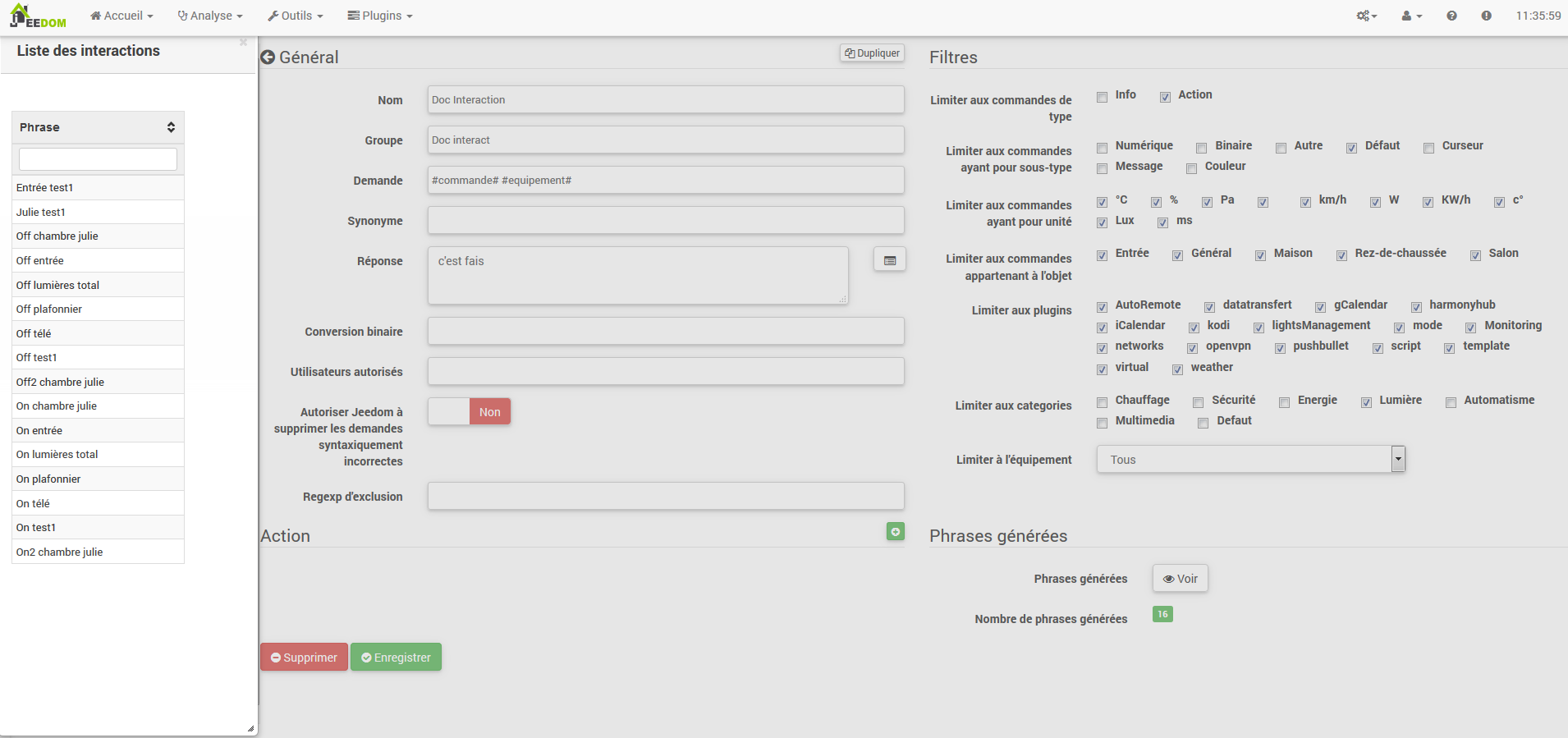

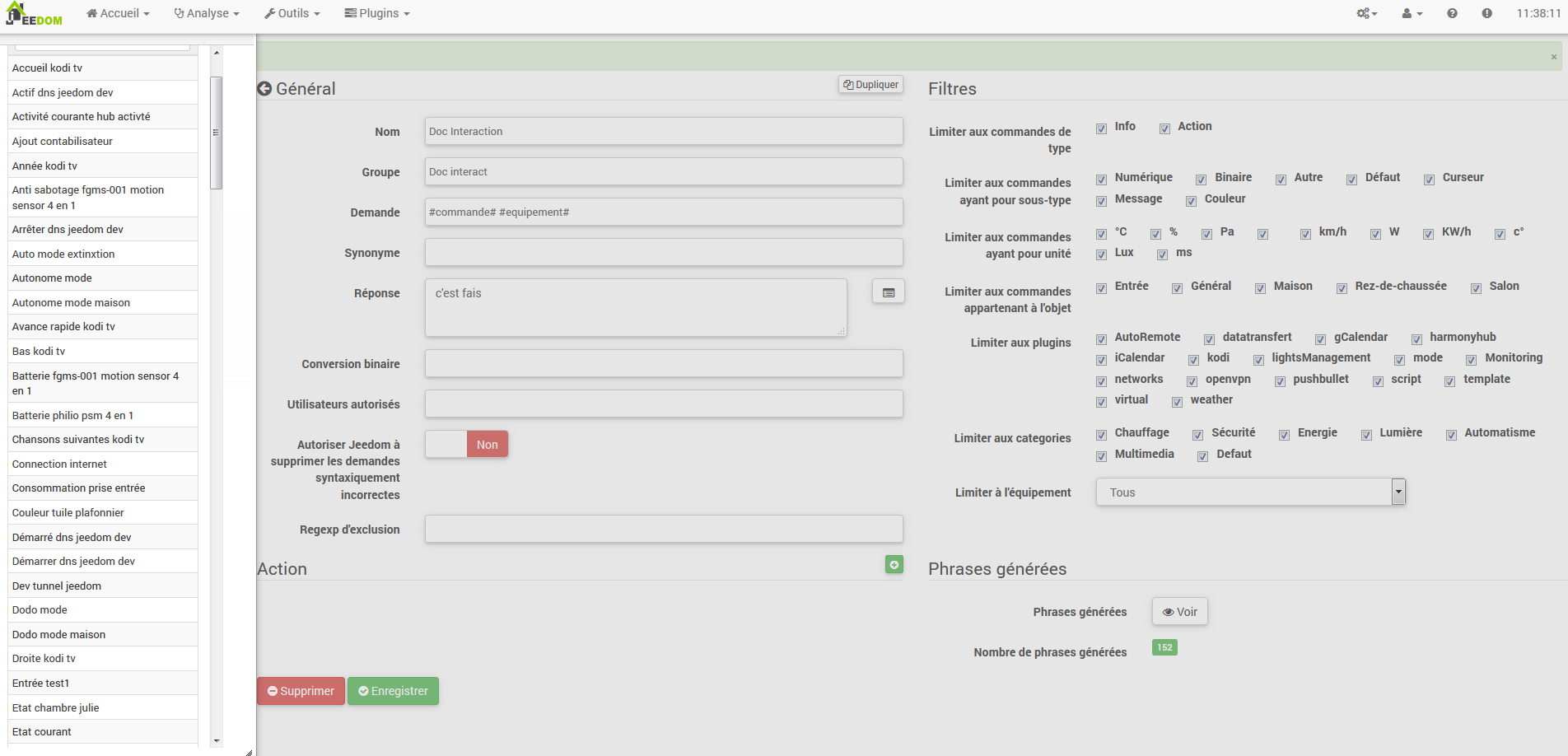

Multiple command interaction
Here we will see all the interest and all the power of interactions, with a model sentence we will be able to generate sentences for a whole group of commands.
We will resume what was done above, delete the actions that we had added, and instead of the fixed sentence, in "Request", we will use the tags #commande# and #equipement#. Jeedom will therefore replace these tags with the name of the commands and the name of the equipment (we can see the importance of having consistent command / equipment names).
interact006
So we can see here that Jeedom generated 152 sentences from our model. However, they are not very well built and we have a bit of everything.
To make order in all this, we will use the filters (right part of our configuration page). In this example, we want to generate sentences to turn on lights. We can therefore uncheck the type of info command (if I save, I only have 95 sentences left), then, in the subtypes, we can only keep checked “default” which corresponds to the action button ( so there are only 16 sentences left).

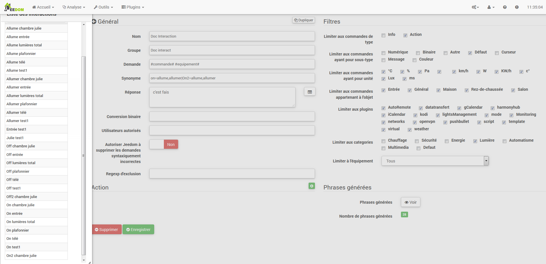

It's better, but we can make it even more natural. If I take the generated example “On entry”, it would be nice to be able to transform this sentence into “turn on the entry” or “turn on the entry”. To do this, Jeedom has, under the request field, a synonymous field which will allow us to name the name of the commands differently in our "generated" sentences, here it is "on", I even have "on2 "in modules that can control 2 outputs.
In synonyms, we will therefore indicate the name of the command and the synonym (s) to use :
interact008
We can see here a somewhat new syntax for synonyms. A command name can have several synonyms, here “on” has the synonym “turn on” and “turn on”. The syntax is therefore “Name of the command=synonym 1,synonym 2” (we can put as many synonym as we want). Then, to add synonyms for another command name, just add a vertical bar after the last synonym “|” after which you can again name the command which will have synonyms as for the first part, etc.
It's already better, but it still lacks for the command "on" "input" the "l" and for others the "la" or "le" or "a", etc. We could change the name of the equipment to add it, it would be a solution, otherwise we can use the variations in the request. This consists of listing a series of possible words at a location in the sentence, Jeedom will therefore generate sentences with these variations.
interact009
We now have slightly more correct sentences with sentences that are not correct, for our example “on” “entry”. so we find "Turn on entry", "Turn on an entry", "Turn on an entry", "Turn on the entry" etc. So we have all the possible variants with what we added between the “\ []” and this for each synonym, which quickly generates a lot of sentences (here 168).

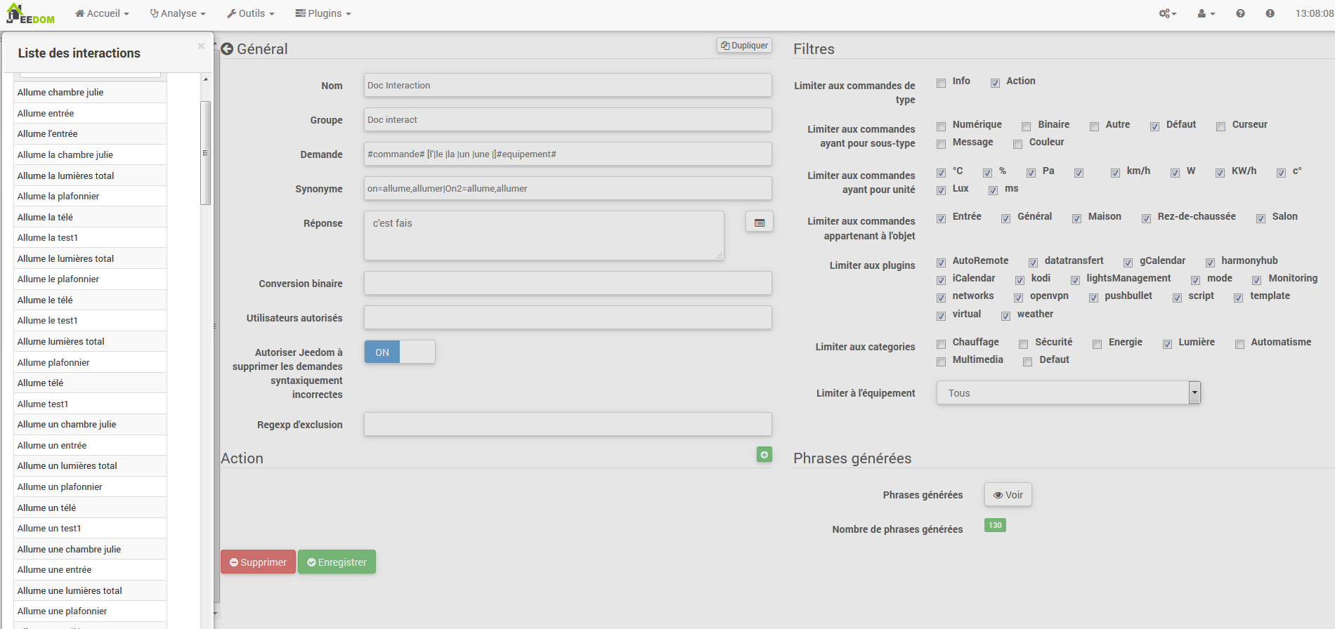

In order to refine and not have improbable things like "turn on the TV", we can allow Jeedom to delete syntactically incorrect requests. It will therefore delete what is too far from the actual syntax of a sentence. In our case, we go from 168 sentences to 130 sentences.
interact010
It therefore becomes important to build your model sentences and synonyms well and to select the right filters so as not to generate too many unnecessary sentences. Personally, I find it interesting to have some inconsistencies of the style "an entry" because if at home, you have a foreign person who does not speak French correctly, the interactions will still work.

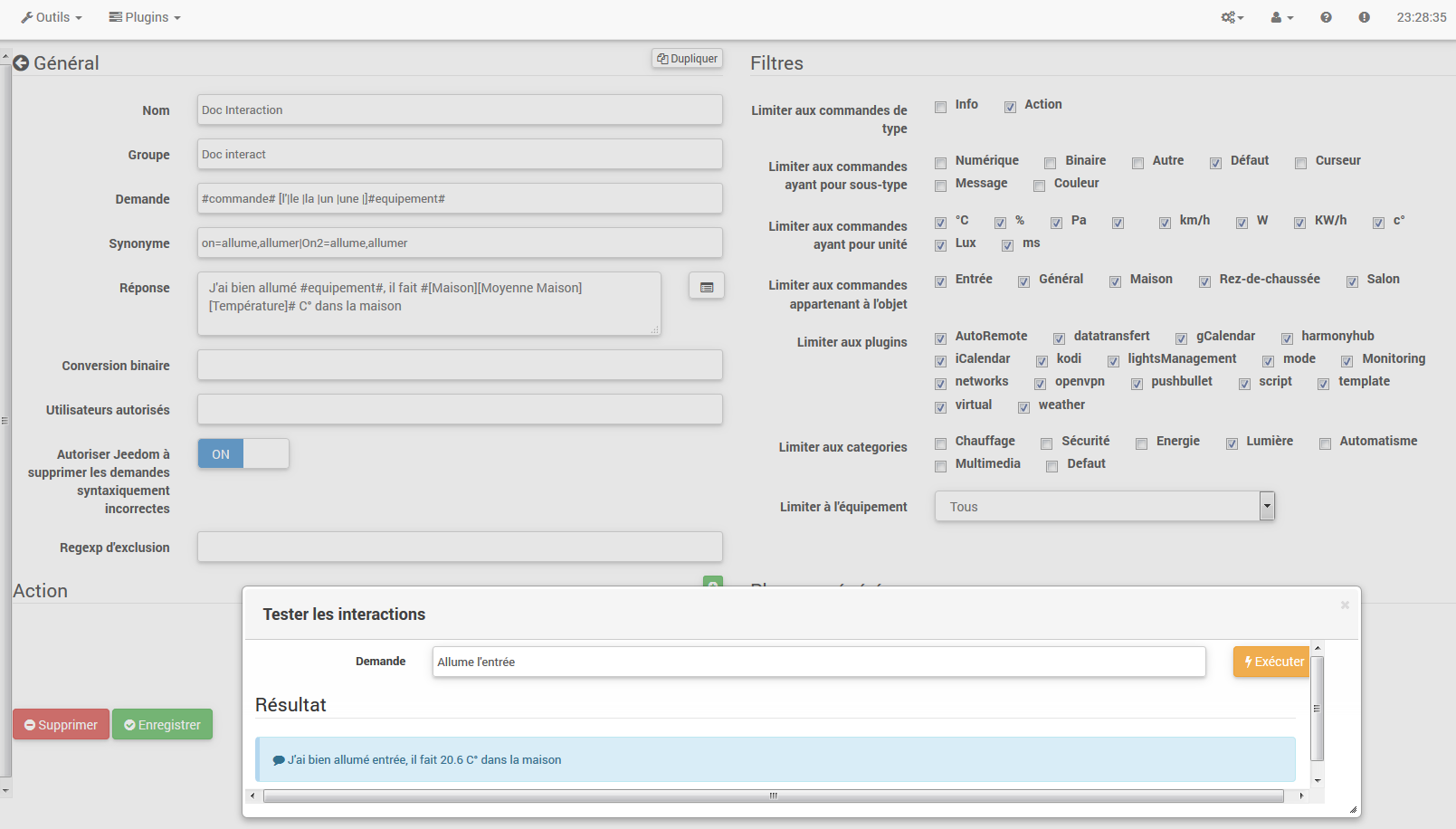

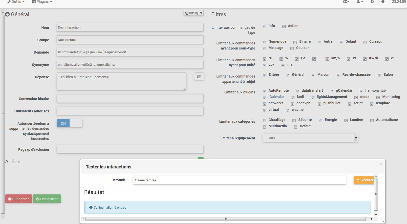

Customize responses
Until now, as a response to an interaction, we had a simple sentence that didn't say much except that something happened. The idea would be that Jeedom tells us what he did a little more precisely. This is where the response field comes in, where we will be able to customize the return according to the command executed.
To do this, we will again use the Jeedom Tag. For our lights, we can use a phrase of the style : I turned on #equipement# (see screenshot below).
interact011

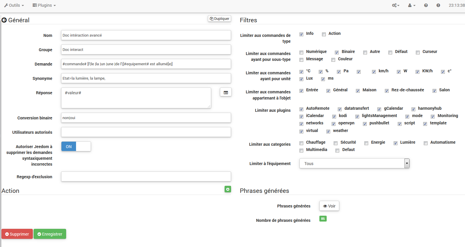

Binary conversion
Binary conversions apply to info type commands whose subtype is binary (returns 0 or 1 only). So you have to activate the right filters, as we can see on the screenshot a little lower (for the categories, we can check all of them, for the example I only kept light).
interact013
As we can see here, I have kept almost the same structure for the request (it is voluntary to focus on the specifics). Of course, I adapted the synonyms to have something coherent. However, for the answer, it is imperative to put only #valeur# which represents the 0 or 1 that Jeedom will replace with the following binary conversion.
Field Binary conversion must contain 2 answers : first the answer if the value of the command is 0, then a vertical bar “|” separation and finally the response if the command is worth 1. Here the answers are simply no and yes but we could put a little longer sentence.
Warning
Tags do not work in binary conversions.

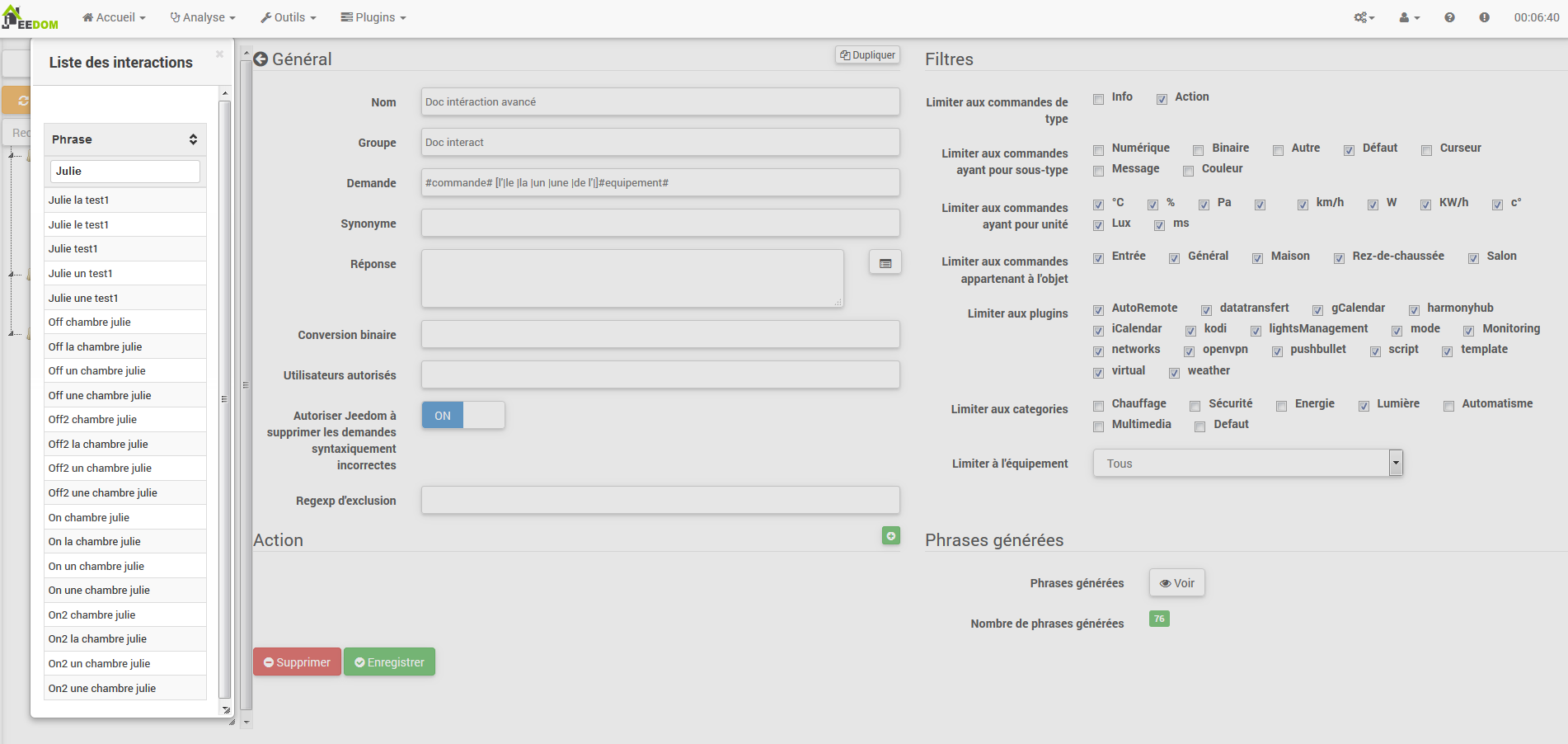

The following screenshot shows the interaction without the Regexp. In the list on the left, I filter the sentences to show you only the sentences that will be deleted. In reality there are 76 sentences generated with the configuration of the interaction.
interact014
As you can see on the following screenshot, I added a simple regexp which will search for the word "Julie" in the generated sentences and delete them. However, we can see in the list on the left that there are always sentences with the word "julie", in regular expressions, Julie is not equal to julie, this is called a case sensitivity or in good French a capital letter is different from a lowercase. As we can see in the following screenshot, there are only 71 sentences left, the 5 with a "Julie" have been deleted.

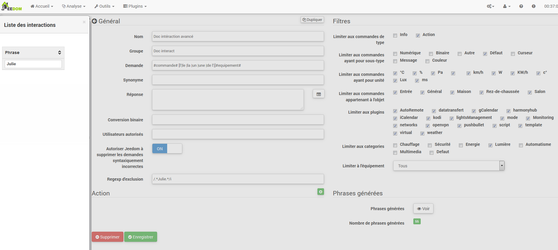

interact015
To solve the problem of upper and lower case, we can add to our expression an option which will make it case-insensitive, or in other words, which considers a lowercase letter equal to a capital letter; to do this, we simply have to add at the end of our expression an “i”.

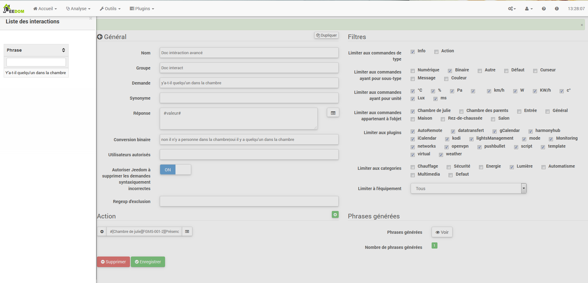

Is there anyone in the room ?
Basic version
interact017
This example specifically targets specific equipment which allows for a personalized response. So we could imagine replacing the answer of the example with “no there is no one in the room Julie|yes there is someone in the room Julie

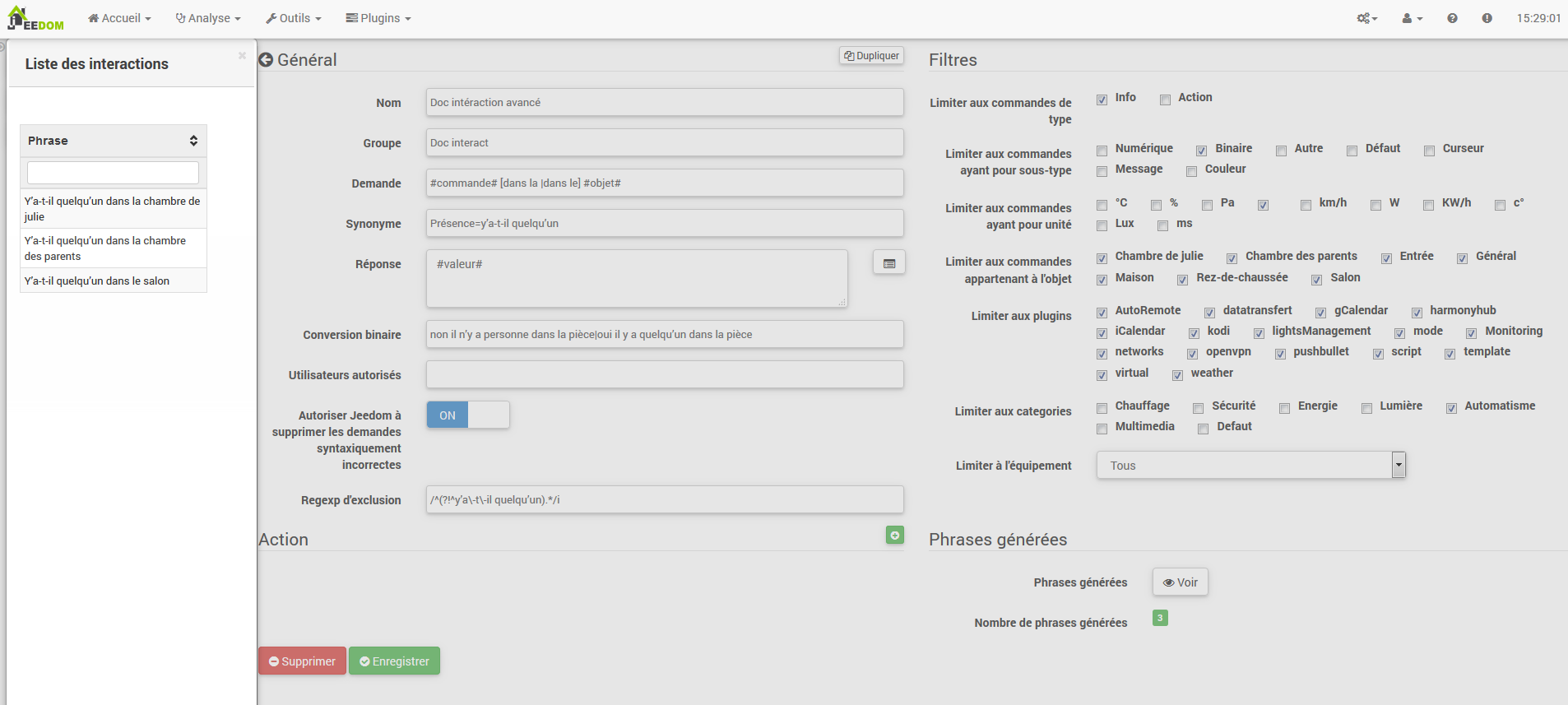

Evolution
interact018
Without the Regexp, we get here 11 sentences, but my interaction aims to generate sentences only to ask if there is someone in a room, so I do not need lamp status or other like outlets, which can be resolved with regexp filtering. To make it even more flexible, you can add synonyms, but in this case you should not forget to modify the regexp.

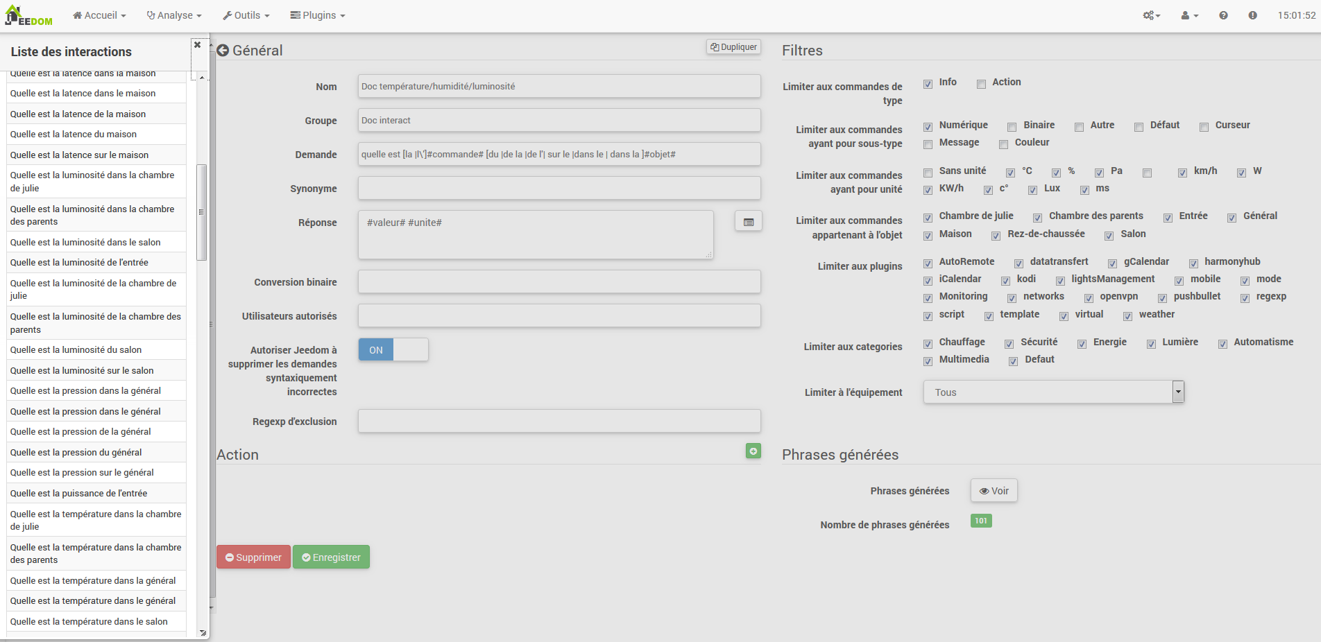

Know the temperature / humidity / brightness
Basic version
We could write the sentence in hard like for example "what is the temperature of the living room", but it would be necessary to make one for each sensor of temperature, brightness and humidity. With the Jeedom sentence generation system, we can therefore generate sentences for all the sensors of these 3 types of measurement with a single interaction.
Here a generic example which is used to know the temperature, humidity, brightness of the different rooms (object in the Jeedom sense).
interact019

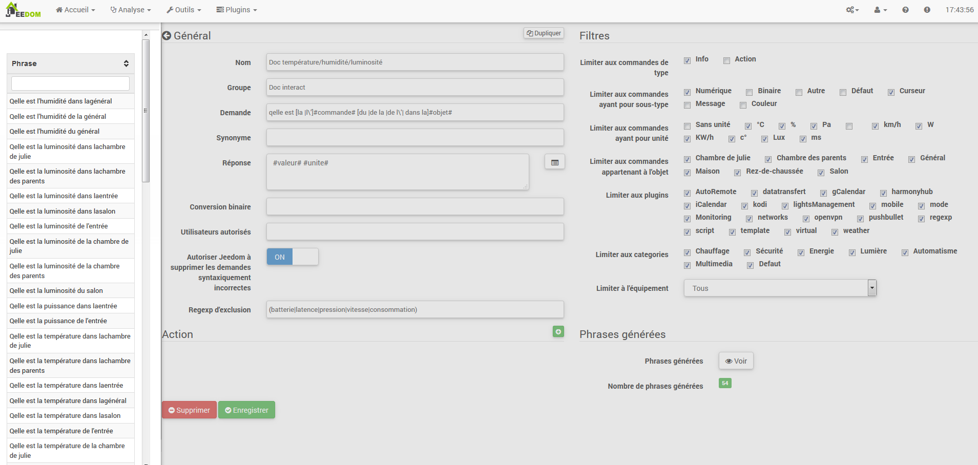

Evolution
We can therefore add synonyms to the command name to have something more natural, add a regexp to filter the commands which have nothing to do with our interaction.
Adding a synonym, lets say to Jeedom that a command called "X" can also be called "Y" and therefore in our sentence if we have "turn on y", Jeedom knows that it is turn on x. This method is very convenient for renaming command names which, when displayed on the screen, are written in an unnatural way, vocally or in a written sentence like “ON””. A button written like this is completely logical but not in the context of a sentence.
We can also add a Regexp filter to remove some commands. Using the simple example, we see sentences "battery" or even "latency", which have nothing to do with our interaction temperature / humidity / brightness.
interact020
So we can see a regexp :
(batterie|latence|pression|vitesse|consommation)
This allows you to delete all commands that have one of these words in their sentence
Note
The regexp here is a simplified version for easy use. We can therefore either use traditional expressions or use simplified expressions as in this example.

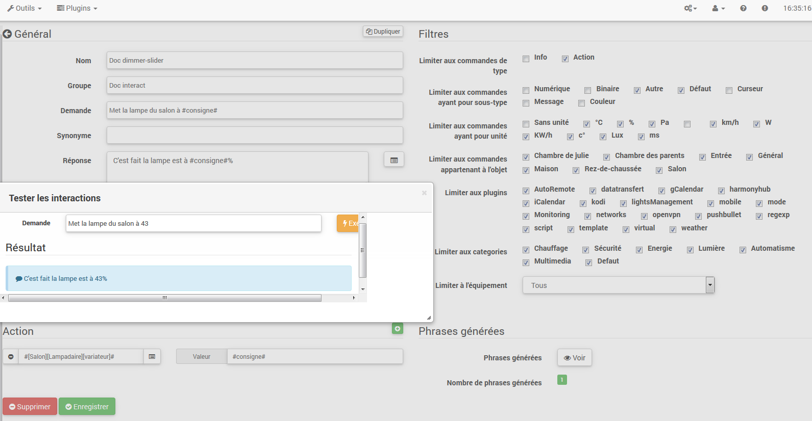

Control a dimmer or a thermostat (slider)
Basic version
It is possible to control a lamp as a percentage (dimmer) or a thermostat with the interactions. Here is an example to control its dimmer on a lamp with interactions :
interact022
As we can see, there is here in the request the tag #consigne# (you can put what you want) which is included in the drive control to apply the desired value. To do this, we have 3 parts : * Demand : in which we create a tag that will represent the value that will be sent to the interaction. * Reply : we reuse the tag for the response to be sure that Jeedom correctly understood the request. * Action : we put an action on the lamp we want to drive and in the value we pass it our tag order.
Note
We can use any tag except those already used by Jeedom, there can be several to control for example several commands. Note also that all the tags are passed to the scenarios launched by the interaction (it is however necessary that the scenario is in “Execute in foreground”).

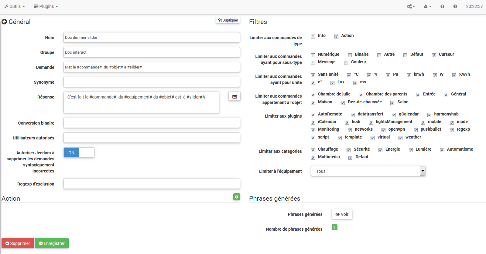

We may want to control all cursor type commands with a single interaction. With the following example, we will therefore be able to control several drives with a single interaction and therefore generate a set of sentences to control them.
interact033
In this interaction, we have no command in the action part, we let Jeedom generate from tags the list of sentences. We can see the tag #slider#. It is imperative to use this tag for instructions in a multiple interaction command, it may not be the last word of the sentence. We can also see in the example that we can use in the response a tag that is not part of the request. The majority of the tags available in the scenarios are also available in the interactions and therefore can be used in a response.
Result of the interaction :
interact034
We can see that the tag #equipement# which is not used in the request is well completed in the response.

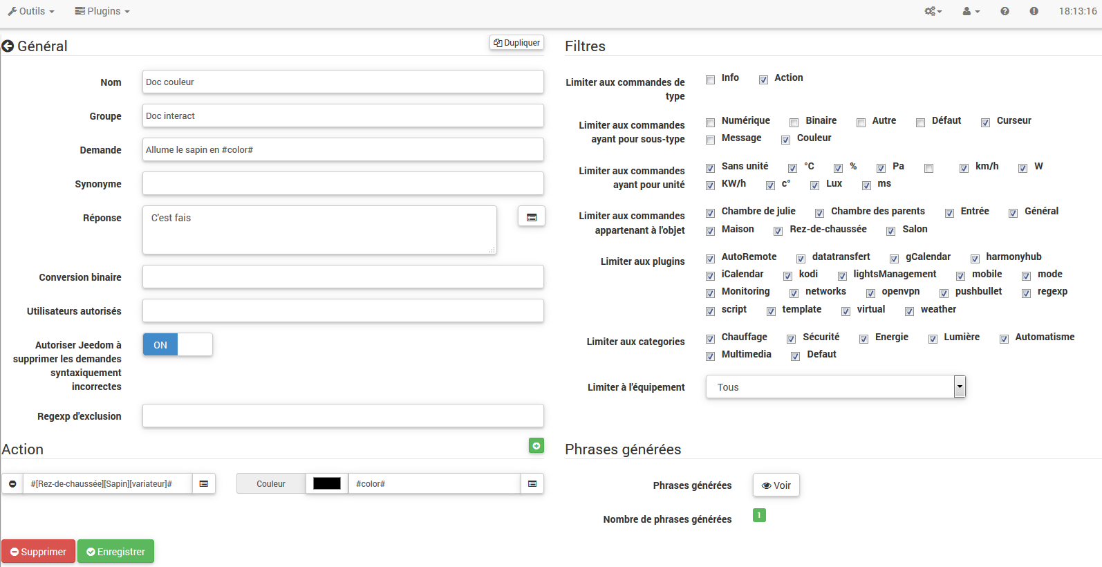

Control the color of an LED strip
It is possible to control a color command by the interactions by asking Jeedom for example to light a blue LED strip. This is the interaction to do :
interact023

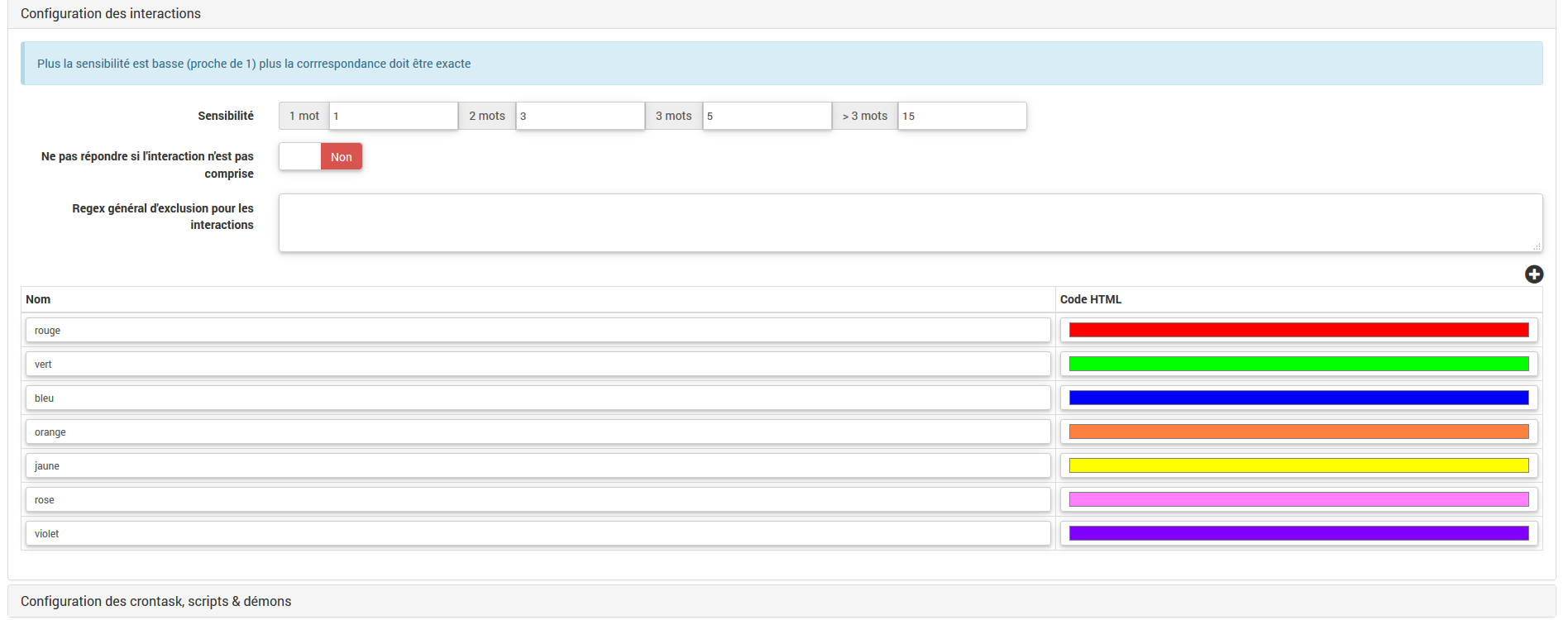

So far nothing complicated, however, you must have configured the colors in Jeedom for it to work; go to the menu → Configuration (top right) then in the “Configuration of interactions” section” :
interact024
As we can see on the screenshot, there is no color configured, so you have to add colors with the "+" on the right. The name of the color, it is the name that you will pass to the interaction, then in the right part (column "HTML code"), by clicking on the black color we can choose a new color.
interact025
We can add as many as we want, we can put any name as any, so we could imagine assigning a color to the name of each member of the family.
Once configured, you say "Light the tree green", Jeedom will search in the request for a color and apply it to the order.

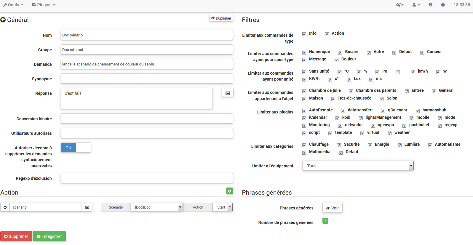

Use coupled with a scenario
Basic version
It is possible to couple an interaction to a scenario in order to carry out actions a little more complex than the execution of a simple action or a request for information.
interact026
This example therefore allows to launch the scenario which is linked in the action part, we can of course have several.
