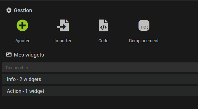

Gestion
Widgets
You have four options :
My widgets
In this part you will find all the widgets that you have created classified by type.
Mes Widgets
Trick
You can open a widget by doing :
  • Click on one of them.
  • Ctrl + Click or Click + Center to open it in a new browser tab.
The search engine allows you to filter the display of widgets according to different criteria (name, type, subtype, etc…). The Esc key cancels the search.
Recherche Widgets
To the right of the search field, three buttons that can be found in several places in Jeedom:
Once on the configuration page of a widget, a context menu is accessible by `` Right Click ‘’ on the tabs of the widget. You can also use a Ctrl + Click or Click + Center to directly open another widget in a new browser tab.
