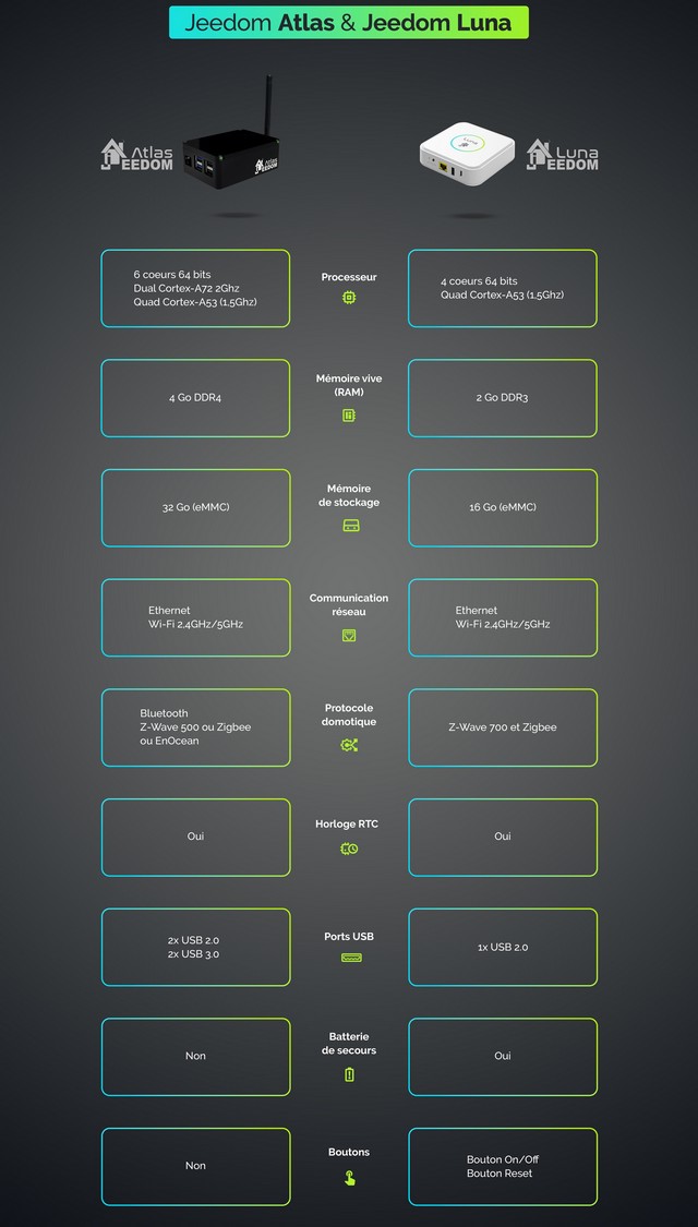

Jeedom Atlas & Jeedom Luna
Jeedom Atlas Jeedom Luna
Atlas sans protocole Luna Z-Wave, Zigbee + BT
Atlas EnOcean Luna Z-Wave, Zigbee + 4G
Atlas EnOcean + clé Z-Wave ZOOZ Luna Z-Wave, Zigbee, LoRaWAN + 4G
Atlas Pro rail DIN sans protocole
Atlas Pro rail DIN EnOcean
Atlas Pro rail DIN KNX
