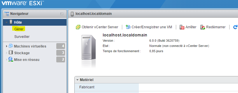

Once you’re logged in to the web interface IP_ESXI/ui Go to “Manage”:

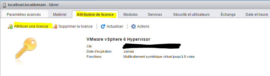

Then go to “License Assignment” and click “Assign a License”
vmware.tips2
And enter your license key

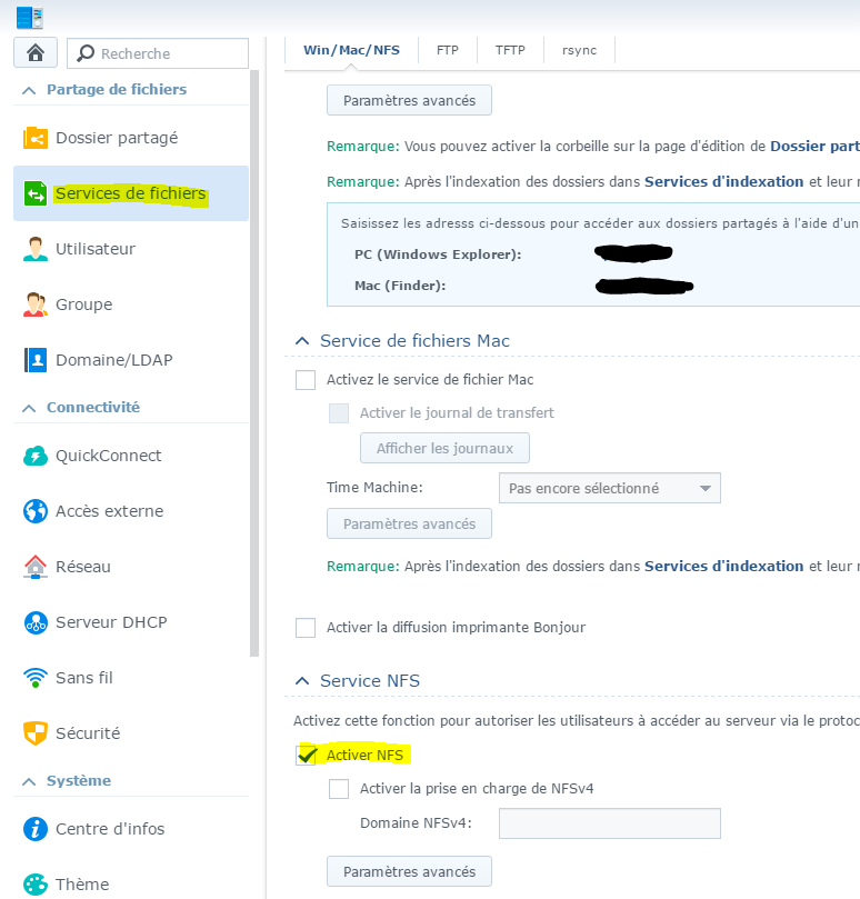

Go to the Control Panel, then “File Services,” and check the “Enable NFS” box:
vmware.tips4

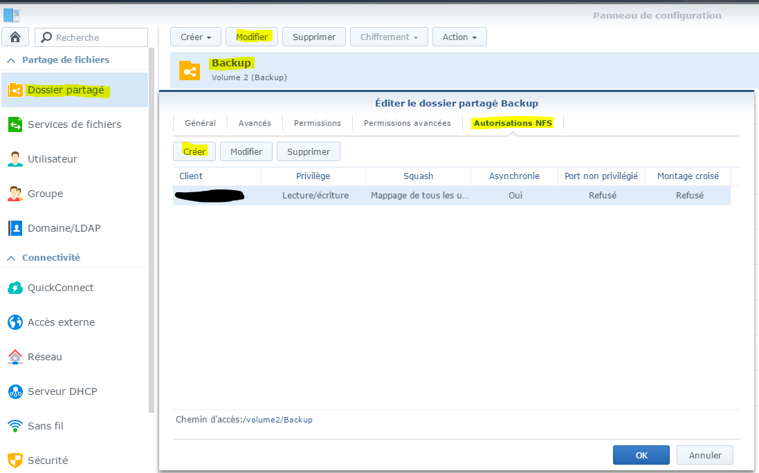

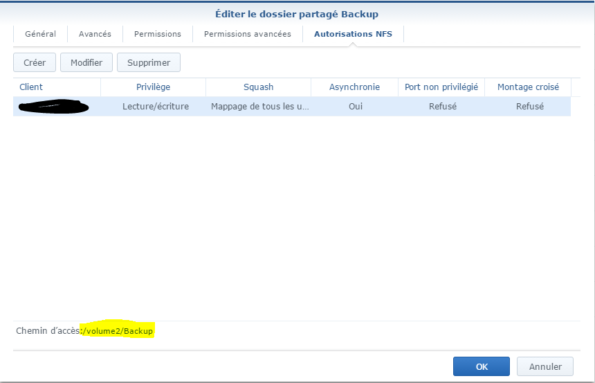

Next, click on “Shared Folder,” then select the folder you want to share (in this case, “Backup”), click “Edit,” then “NFS Permissions,” and finally “Create” (in this case, I already have one; your list should be empty):
vmware.tips5

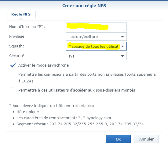

Next, enter the IP address of your ESXi, and under “Squash,” select “Map all users to admin,” then click OK:
vmware.tips6
Next, you need to retrieve the path to the share (here /volume2/Backup) :
vmware.tips7

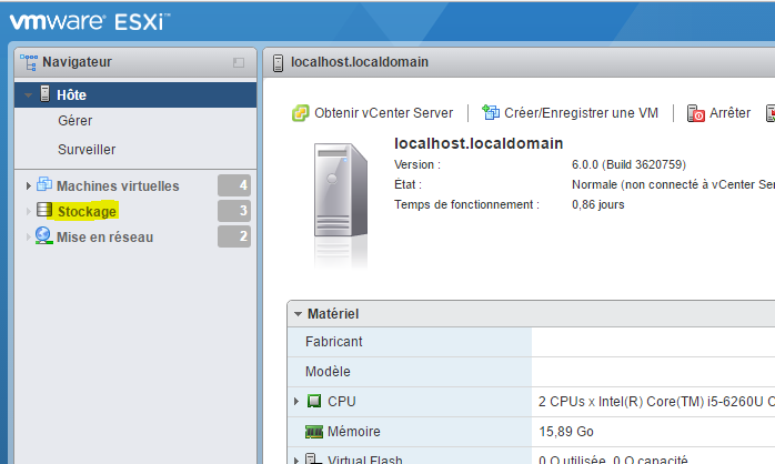

Go to “Storage”:
vmware.tips8

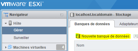

Then click on “New database”:
vmware.tips9

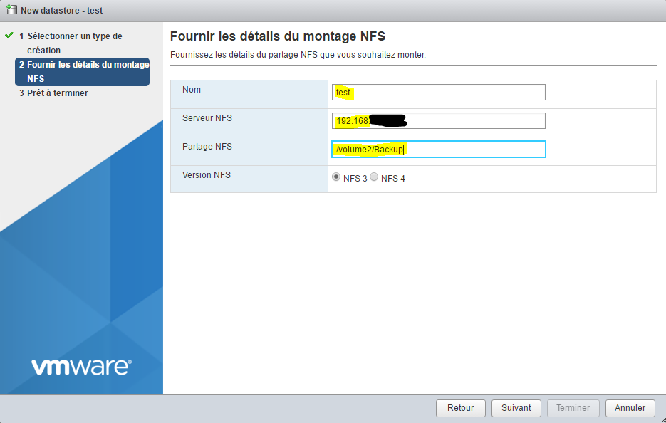

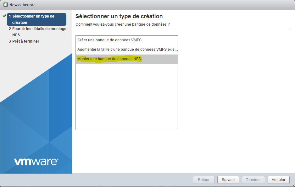

Here, select “Mount an NFS database” and then do the following:
vmware.tips10
Enter the name of the datastore you want to create (be sure to avoid spaces and special characters), enter the IP address of your Synology device, enter the path to the share (see above), and finally click OK:
vmware.tips11

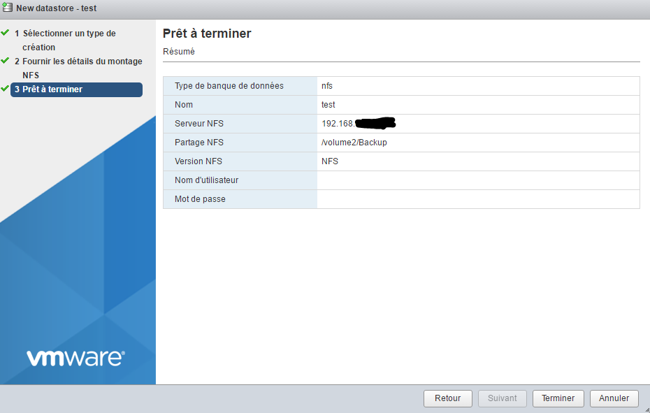

Click “Finish”:
vmware.tips12
And there you go—your new datastore should appear (if not, click “Refresh”).

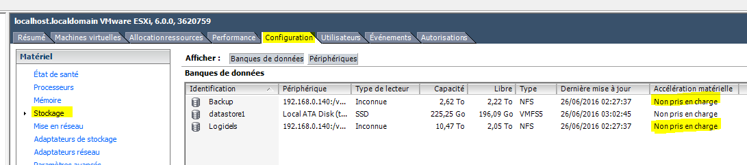

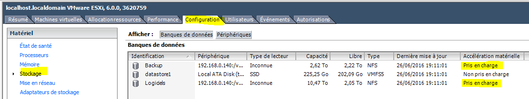

To see if you have it, you need to log in using the desktop client (I couldn’t find this information on the web client) and go to Settings → Storage:
vmware.tips13
Setup is fairly simple. First, you need to enable the SSH service on the ESXi (in the web interface, go to Action ⇒ Services ⇒ Enable Secure Shell), then connect to it via SSH (the login credentials are the same as those used to access the interface). Next, simply do the following:
esxcli software vib install -v https://global.download.synology.com/download/Tools/NFSVAAIPlugin/1.0-0001/VMware_ESXi/esx-nfsplugin.vib -f
You must have:
vmware.tips14
Next, you need to restart the ESXi. To verify that everything is working properly, go back to the thick client and navigate to Configuration → Storage:
vmware.tips15

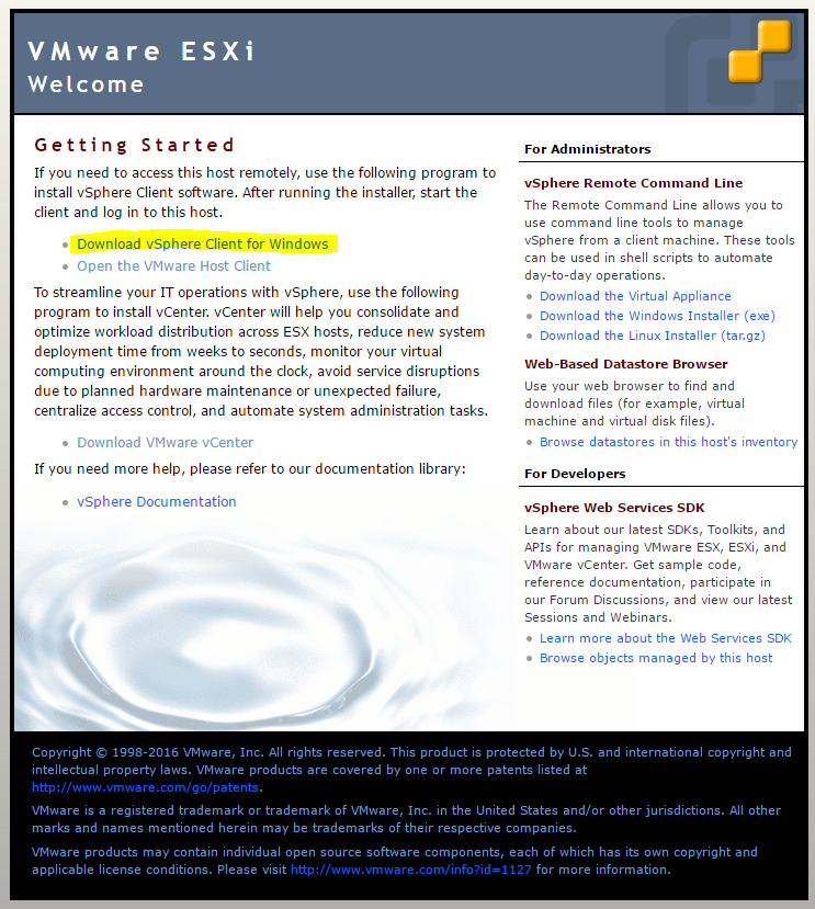

Using your web browser, go to the ESXi’s IP address and then click the link Download vSphere Client for Windows :
vmware.createvm
Once downloaded, simply start the installation (I’m skipping this part on purpose since all you have to do is click “OK” through the prompts).

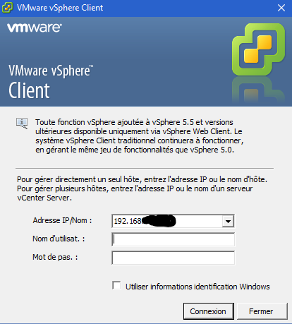

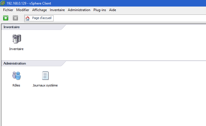

Next, launch VMware vSphere Client. You should see:
vmware.createvm1
Just enter your ESXi’s IP address, username, and password, and you’ll be logged in:
vmware.createvm2

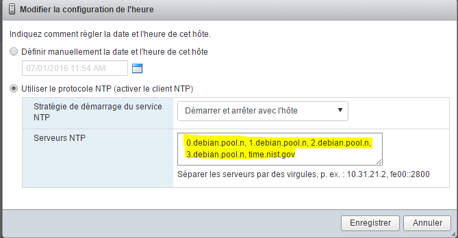

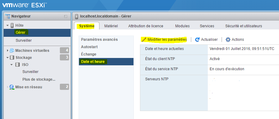

By default, ESXi does not use NTP, which means it is not set to the correct time and the VMs are not set to the correct time either. Fixing this is very simple. From the web interface, go to Manage → System → Date and Time, then click “Edit Settings”:
vmware.tips16
And in the “NTP Server” field, enter: 0.debian.pool.n, 1.debian.pool.n, 2.debian.pool.n, 3.debian.pool.n, time.nist.gov
vmware.tips17

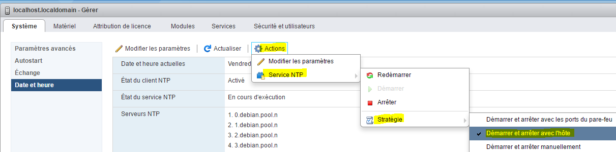

Next, under Actions → NTP Service → Strategy, click “Start and stop with the host”:
vmware.tips18
Still in Actions → NTP Service, click “Start”
There you go—your ESXi should now set the correct time on its own.

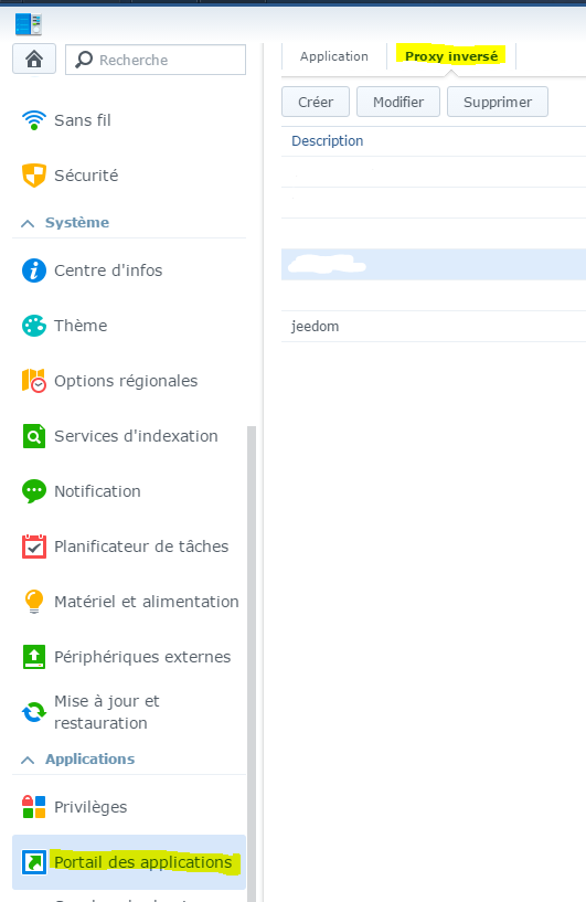

Next, on the NAS, go to the Control Panel, then Application Portal and Reverse Proxy (note: DSM 6 is required):
vmware.tips19

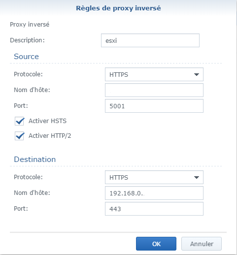

Click “Create” and enter:
vmware.tips20
In “Host Name” (under Source), enter the desired DNS (for example, monesxi.mondsn.synology.me), and in “Host Name” (under Destination), enter the ESXi IP address
