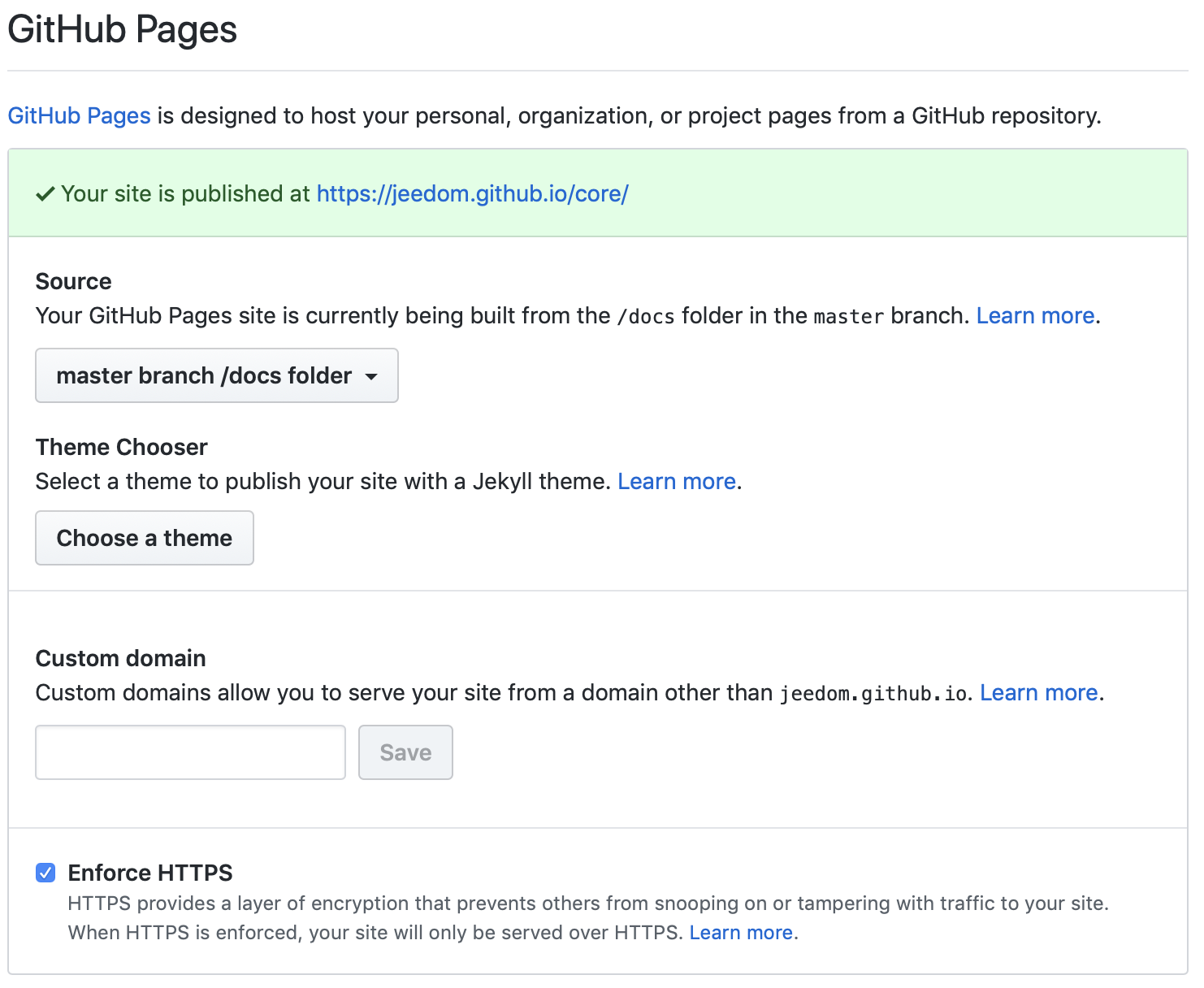

changelog.md => your Changelogindex.md => your documentationPushing your content online is quite simple: just go to your GitHub repository, click “Settings,” and in the “GitHub Pages” section, enable the option for “master branch /docs folder” (as the label indicates, only the files in the /docs folder of your plugin’s master branch will be published online).
GitHub will then provide you with a link of the type https://jeedom.github.io/plugin-template/ (After a few minutes, when you click on it, you should see your documentation formatted correctly.)
