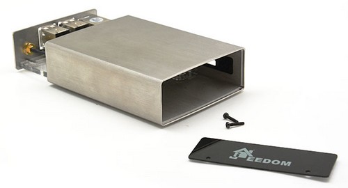

  2. Unscrew the 2 screws on the front of the box near the Plexiglas plate (Caution: Fragile!).
  3. Slide the motherboard toward the back of the case:

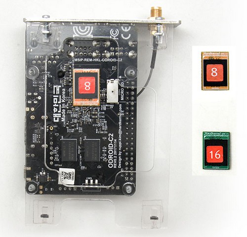

  1. Unclip the eMMC storage module located under the motherboard:
Unclip the eMMC

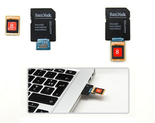

  1. Snap the eMMC onto the adapter and plug it into a computer:
eMMC on a PC
  1. Open the burning software (such as balenaEtcher).
  2. Select the system image file as the source, the eMMC as the destination, and then start the burn process.
  3. Once the burning process is complete, unplug the adapter from the computer, then unclip the eMMC and clip it back into place under the Smart’s motherboard.

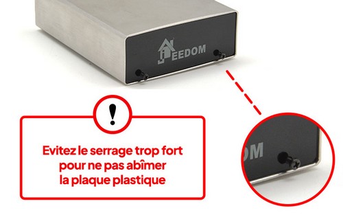

  2. Replace the plexiglass and then tighten the two screws on the front of the box without using excessive force:
