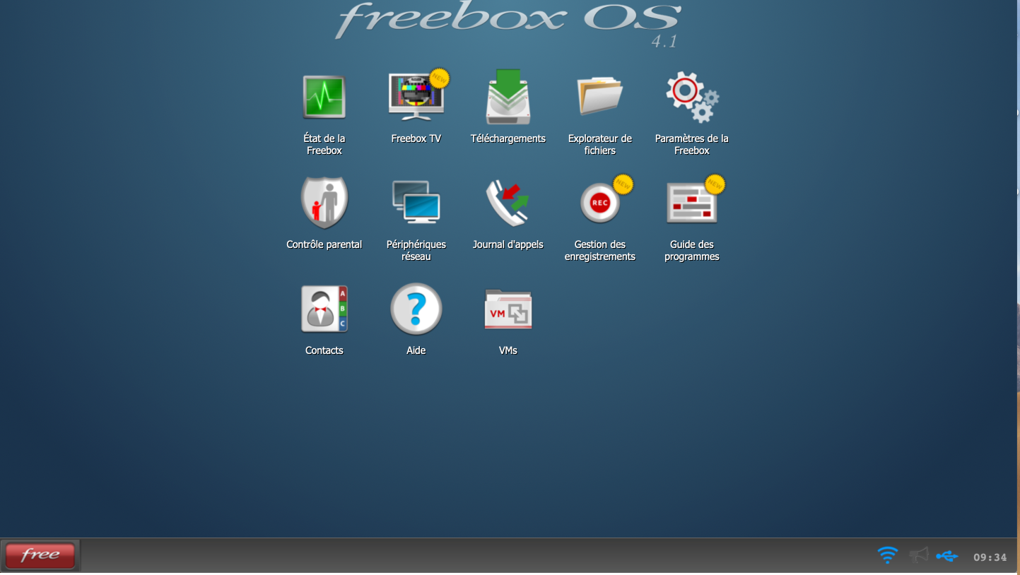

Go to the configuration interface for your Freebox Delta. Then click on VMs.

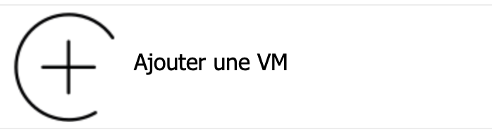

Click “Add a VM” delta2

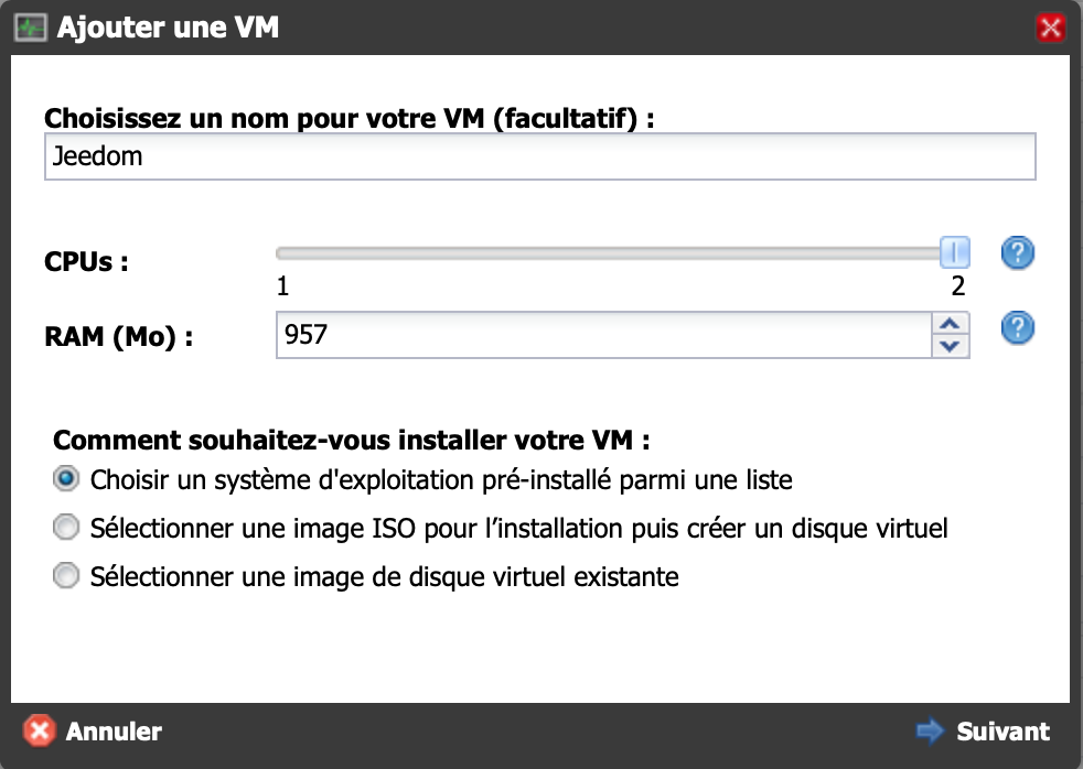

Configure the specifications. We recommend using 2 CPUs and the maximum amount of RAM.
delta3

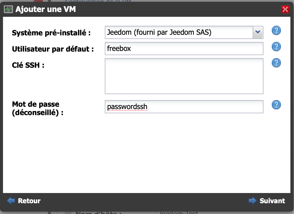

Set up the username and password; be sure to remember them, as you’ll be asked for them when connecting via SSH: delta4

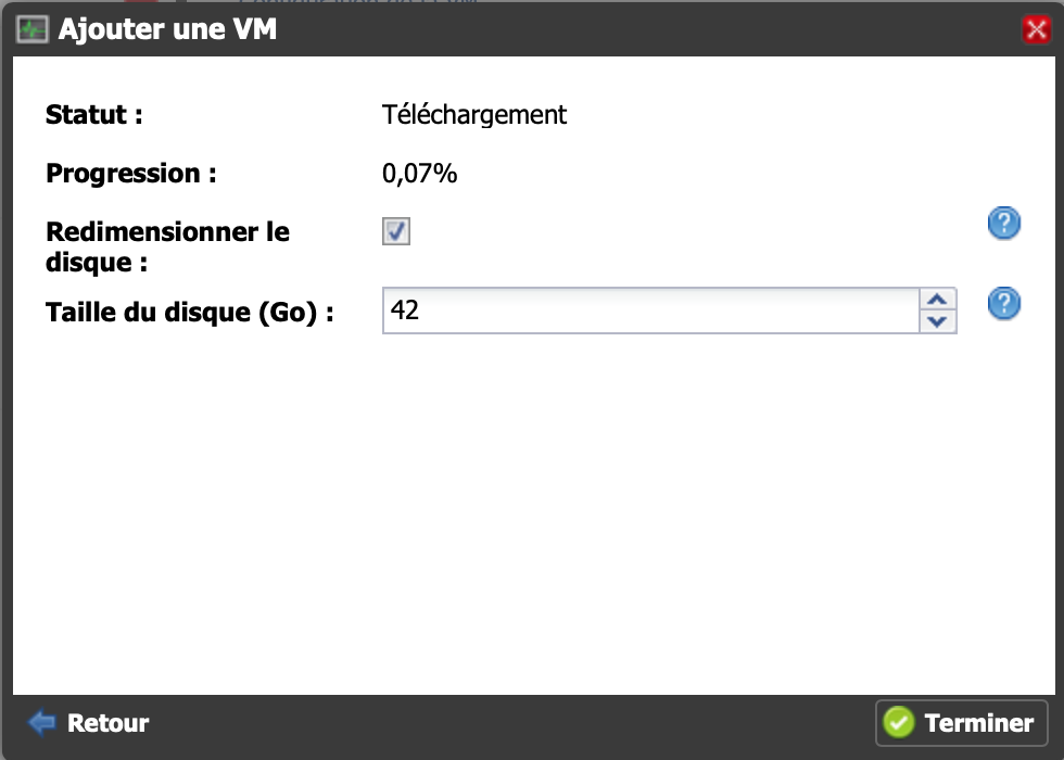

Installation in progress
Please wait while the image downloads delta5

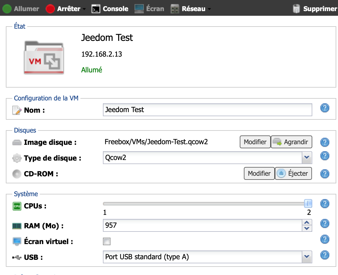

You can log in using the address provided on the page: delta6
Be sure to assign the Delta’s USB port to the VM if you want to use an antenna.
Do not check “Screen”; this serves no purpose on the Jeedom screen (other than wasting power).
The IP address of your Jeedom on the Freebox Delta is listed at the top, below its name.
The default username and password are admin/admin when you access Jeedom through your browser.
