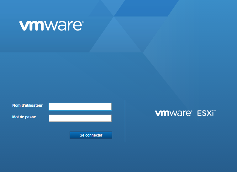

Logging in to the web interface
Go to IP_ESXI/ui in your web browser; you should see:
vmware.createvm3
Note
If you don’t have anything set up yet, I recommend installing the web interface; all the information here

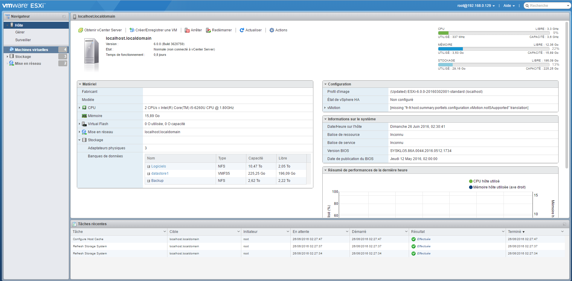

Enter your ESXi login credentials:
vmware.createvm4
As you can see, the interface is pretty cool and lets you do quite a few things. I won’t go into detail, but from this screen alone, you can already:

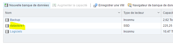

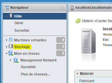

To do this, click on “datastore”:
vmware.createvm18

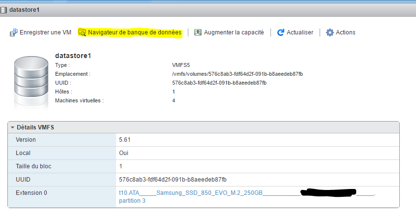

Select your datastore (usually named datastore1):
vmware.createvm19

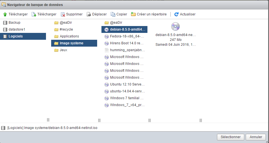

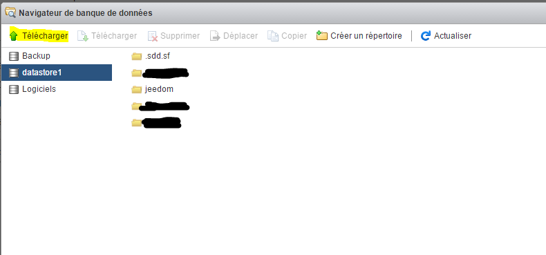

Click “Database Browser”:
vmware.createvm20

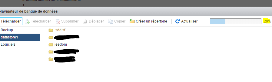

Click “Download” (the first one):
vmware.createvm21
Select the previously downloaded ISO file and confirm:
vmware.createvm22
You can then track the progress of the shipment:
vmware.createvm23
Once it’s finished, you can see that your ISO has been successfully uploaded to the datastore:
vmware.createvm24

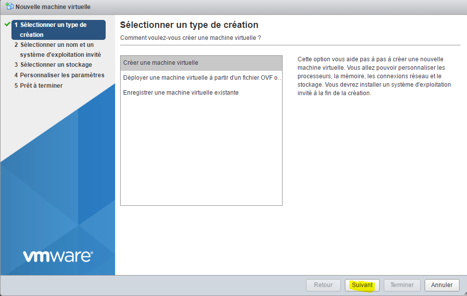

Click the “Create/Save a VM” button:
vmware.createvm5
Click Next:
vmware.createvm6

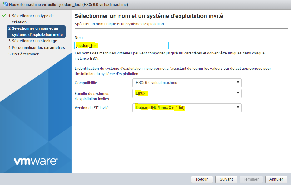

Next, give your machine a name and specify its operating system (here we’ll be installing Debian):
vmware.createvm7

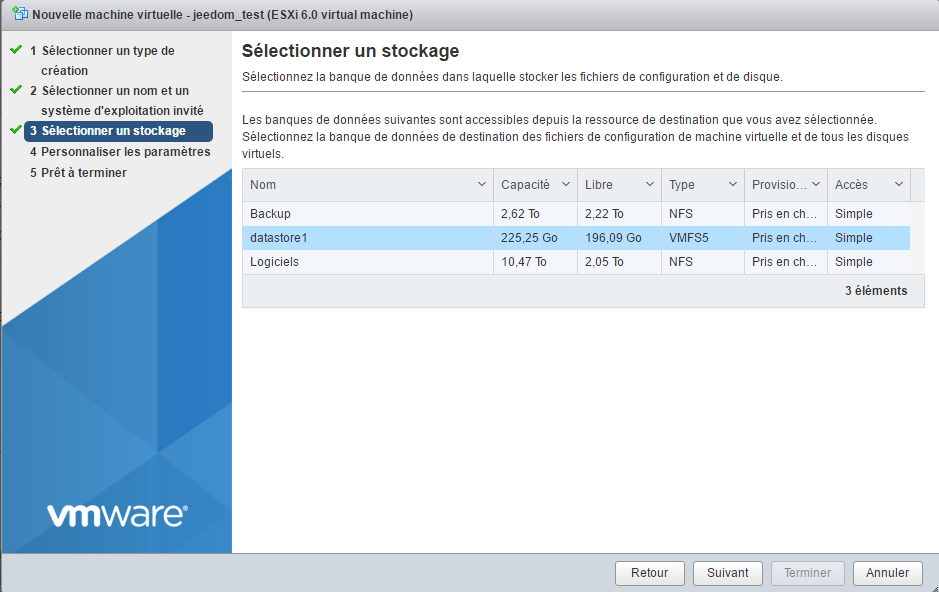

Specify the target datastore:
vmware.createvm8

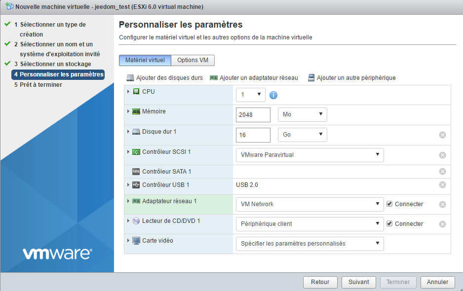

Here you can configure your machine’s settings (hard drive, CPU, memory, etc.):
vmware.createvm9
Note
All of these settings can be changed later without any issues. Note, however, that it’s not truly possible to reduce the size of a hard drive; you can increase it (but you’ll need to manage that at the OS level afterward), but not decrease it.

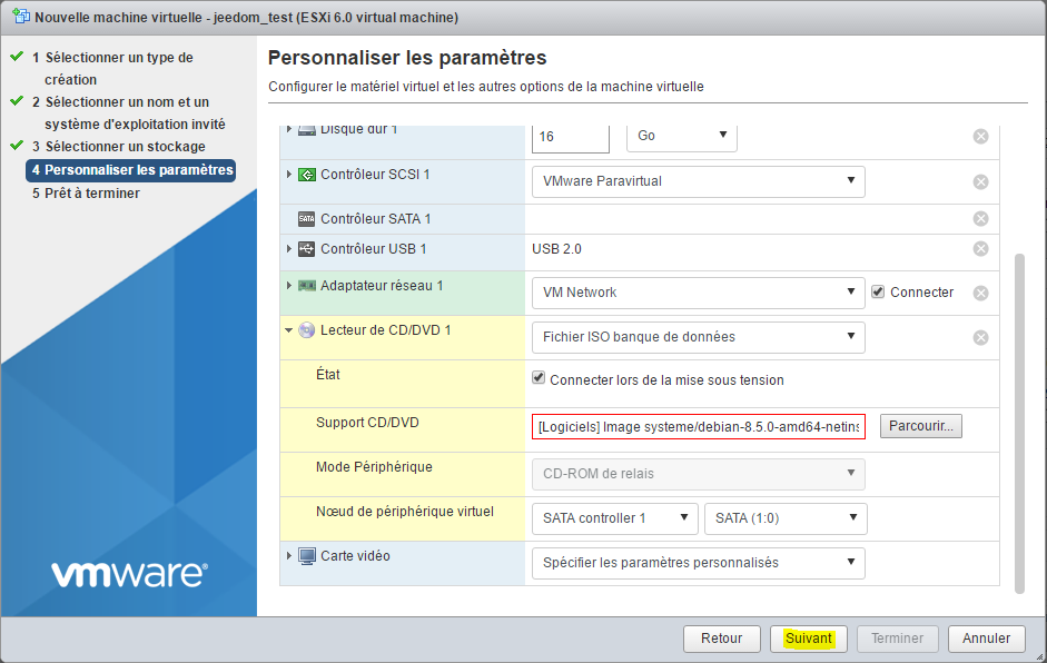

In the CD/DVD drive, select “Database ISO File”:
vmware.createvm10
Next, select the location where your ISO file is stored (see the previous section) and confirm:
vmware.createvm11

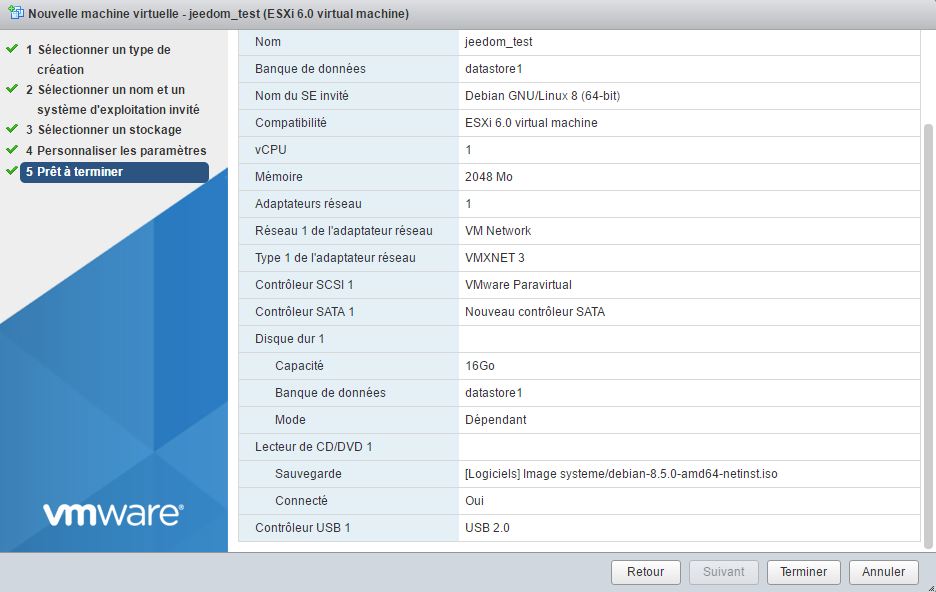

You will then see a summary of your configuration; click “Finish”:
vmware.createvm13

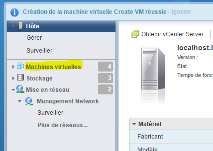

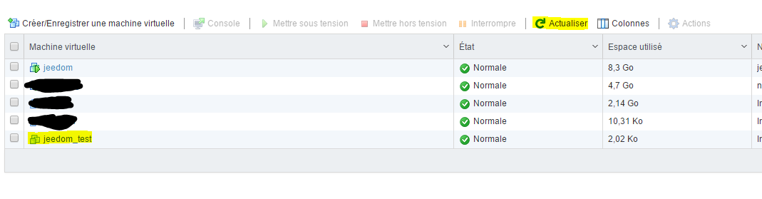

A message at the top will let you know that everything is set; then click on “Virtual Machines”:
vmware.createvm14

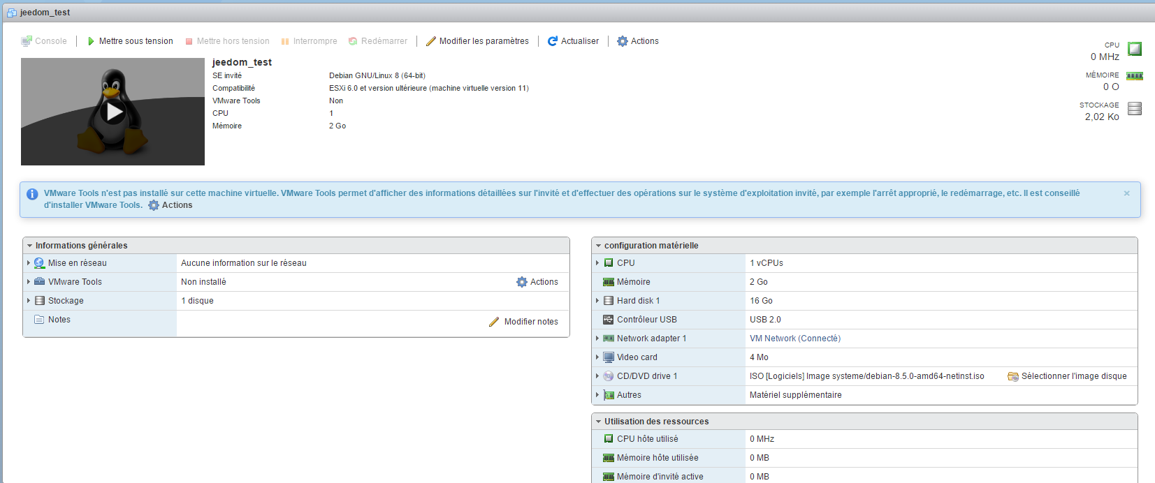

You should see your virtual machine (if not, click “Refresh”); click on it:
vmware.createvm15

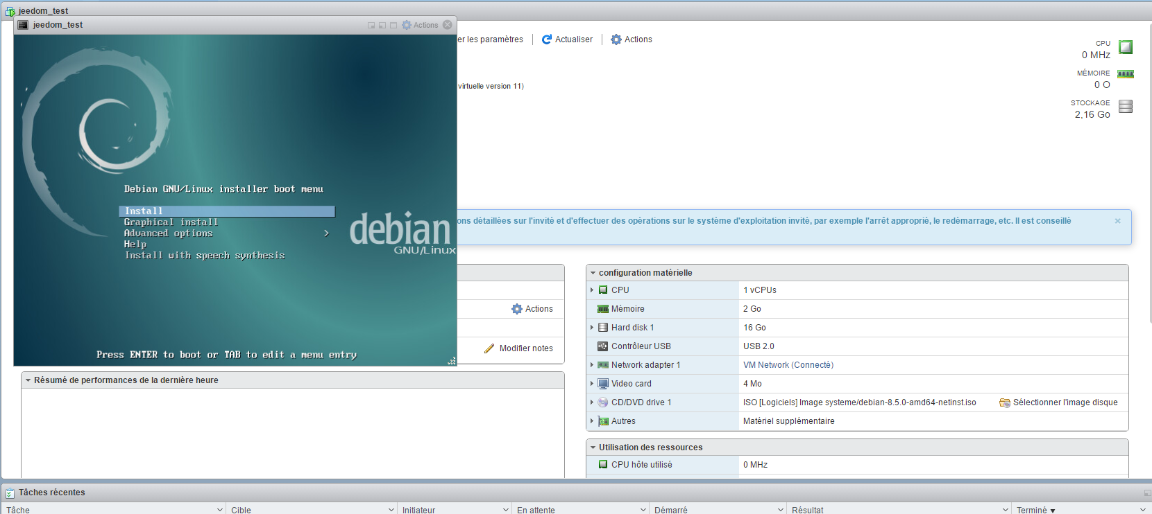

You should see a page of this type; click the play button:
vmware.createvm16
Your machine will start up, and you’ll be able to install your operating system:
vmware.createvm17
Important
Once your machine is installed, you MUST install the VMware Tools (this allows VMware to access information about your VM and shut it down properly). On Debian, simply run “sudo apt-get -y install open-vm-tools”.

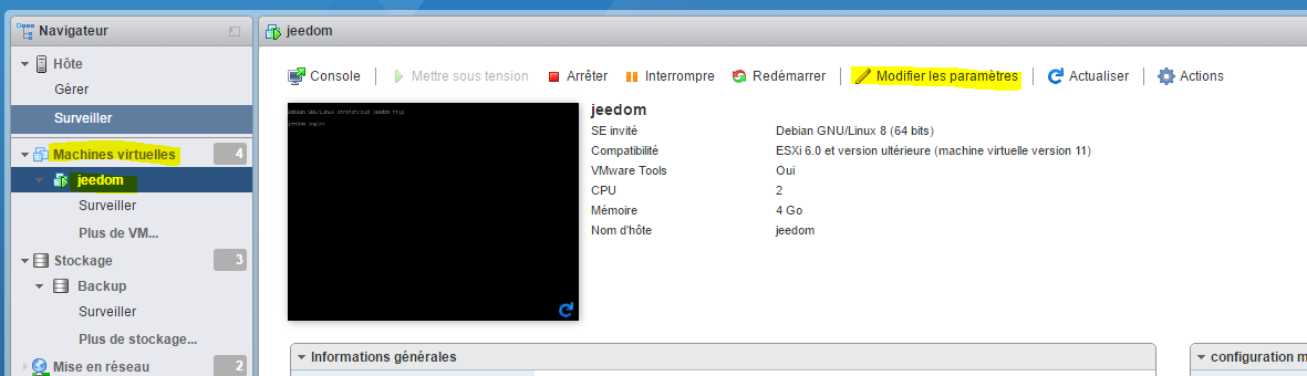

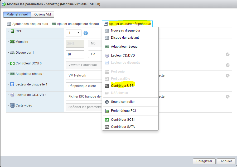

Go to your VM and click “Edit Settings”:
vmware.createvm25

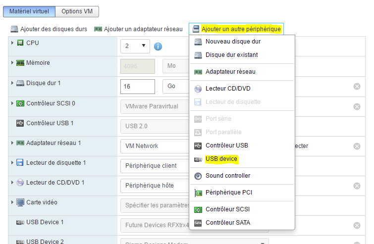

Click “Add Another Device,” then select USB controller:
vmware.createvm26
Note
The following step must be repeated for each USB device you want to connect
Save, go back to “Edit Settings,” then select “Add Another Device” and “USB Device”:
vmware.createvm27
Select your USB device from the drop-down list:
vmware.createvm28
